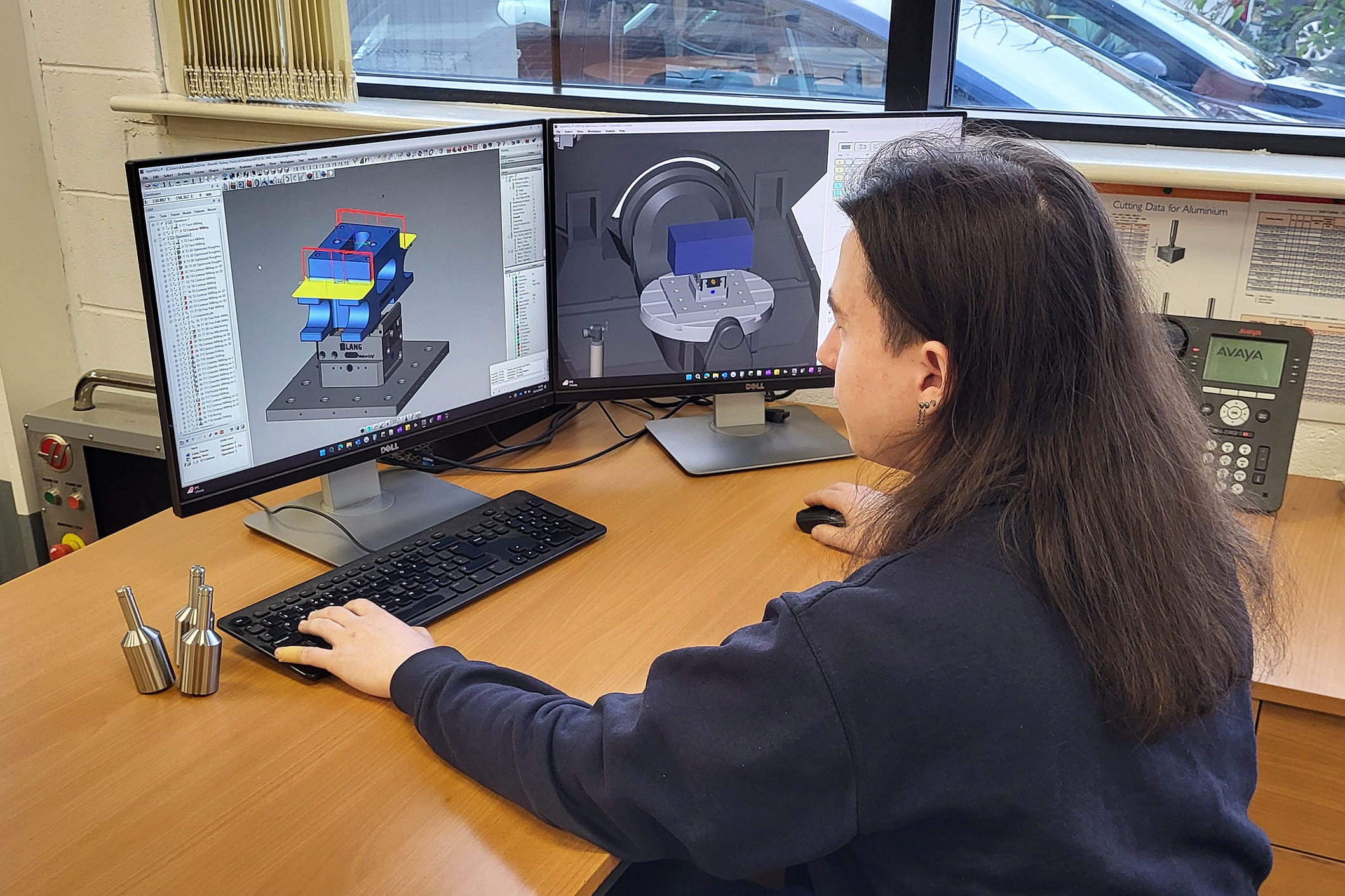

Howells Rail CNC Programmer Alexander Barnes programming with hyperMILL®

One of the most significant improvements since adopting hyperMILL® has been the step-change in simulation capability. For Howells' CNC Programmer Alexander Barnes, who works directly with the software on a daily basis, Virtual Machine has fundamentally changed how jobs are prepared and verified before they reach the machine tool.
Alexander says: "hyperMILL® makes it easy to go from rough to finish parts because it uses the model to drive the tool path, so I know it's not going to gouge anywhere along the workpiece. From there, it generates the stock model straight away, so if I need to do some rest roughing, I can easily work to that stock model. For the finishing, it works in the same way, driving up to the surface of the model."
For 5-axis machining in particular, where multi-axis movements create a complex collision environment that potentially involves the cutting tool, spindle, workholding and the machine structure, simulation is a necessity. Alexander explains how hyperMILL®'s Virtual Machine addresses this challenge head-on. "The simulation on our 5-axis machines is very important for collision checking and to prevent gouging on the parts. Within Virtual Machine, collisions are automatically recognised, and the system will not let you post the code. I can confidently post the code and know that with every B and C-axis movement that we're going to have, I'm not going to gouge into the machine itself."

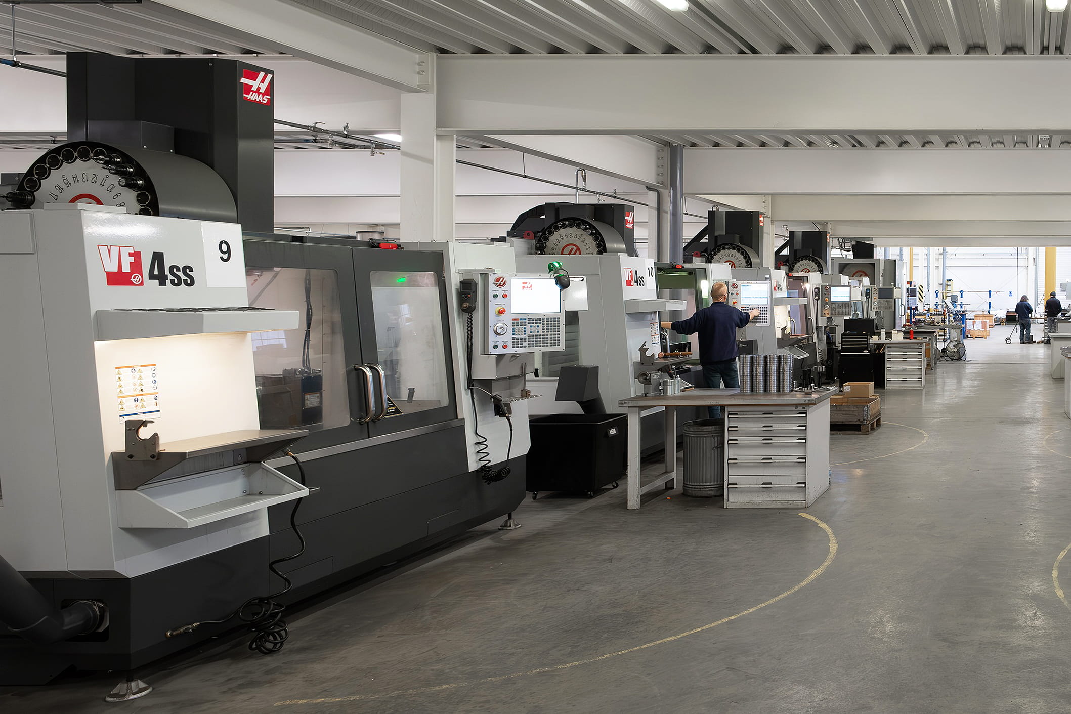

 – A row of machines programmed with <em>hyper</em>MILL<sup>®</sup> at Howells Rail
A row of machines programmed with hyperMILL® at Howells Rail

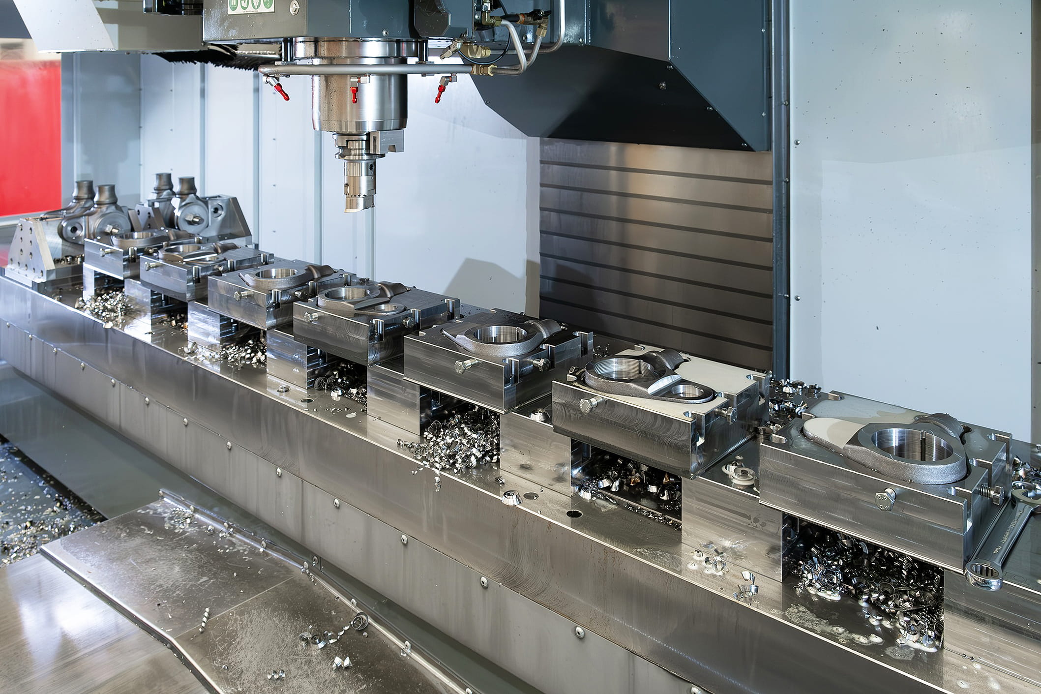

 – A batch of rail components manufactured at Howells
